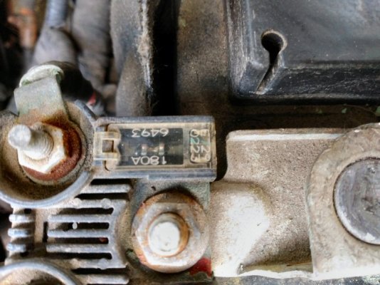

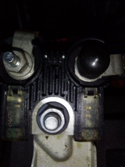

Something else I noticed is what looks like fuses in the battery clamp? Never seen anything like this before. One of them actually looks kinda funky. Could this be part of the problem?
Looking at that pic, those connections need some love. I would consider those "bad" connections and refurb them.
I would not use dielectric grease on the connections because dielectric is an insulating grease.

Yeah, those are the before pics. I cleaned that all up. Are those fuses though? I'm not real sure what I'm looking at. How do they come out? The grease thing I go back and forth on. I know it's actually an insulator, but it seems many connections benefit from it.

Yes, high current fuses.
IIRC, my truck has a 120 A & 180 A fuse.
Likely for things like the starter and alternator.
To my knowledge the fused battery clamp is changed as a unit, at least from Mopar. :cool:
