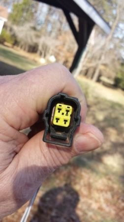

I thought I had two spare O2s but when I went to actually plug one into the wiring harness the plug is keyed ever so slightly different. I believe the two sensors I have are for 04+ model using two front O2s. Anyone needing these can contact me.
Do you have any pics of the connector? I know there are a couple different types, one is keyed straight across and the other is offset on each side from center.

The 03 sensor that I have is keyed in the center. The 04+ one's I have has the center key off center. Interesting on RockAuto under the pn listing for 56041698AA (03) also has universal O2s that have wide slots to accept the different keys offsets. This would indicate to me that they are exchangeable. But also know the 03 is very particular about what parts are used. So don't really know. I received a OEM O2s today and will install tomorrow to see how it reads. Curious...

I actually got the wrong set the first go round, they were keyed centered and my engine harness was off centered. The part number was 56029049AA, and they fit 04-05 and 09-12 5.7. Luckily 09smokinhemi was able to use them so I recouped a little bit of my money. I just replaced the upstream sensors today, and if the ones you have don't work out and fit mine I may take them off your hands to do my downstream ones.
