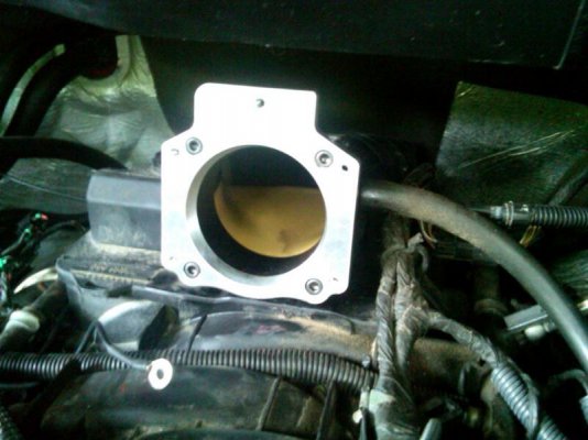

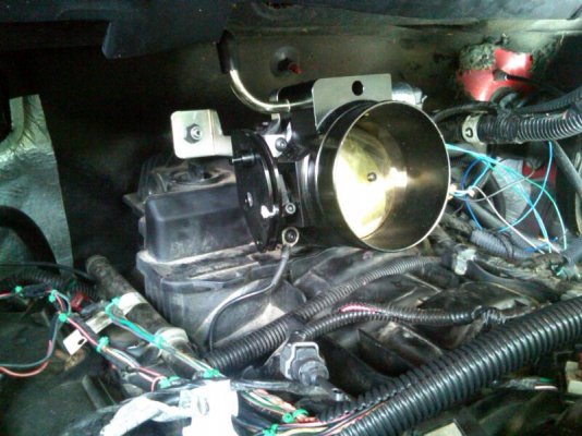

One of your main concerns should be what you are intending to do about the Throttle body. 4.7 doesn't use FBW, all hemi's have FBW. Meaning if you are going to keep the FBW TB then you have to change PCM's. The preferred being 05 for tunability. Personally if given a chance to dump the FBW I would do so in a heartbeat. Now this would make things easier for you to keep your 4.7 PCM and tune it for the Hemi. There are several ways to use a cable driven TB on the Hemi. As for the transmission I haven't done any research, but I'd run what you have getting the engine sorted out and then convert to a 6 spd at a later date. This would get you running and allow time for you to nail down exactly what you want to go with and gather parts. Anyway my two cents.
These are some pictures of a drive by cable conversion I did when using a stand alone tuner.
