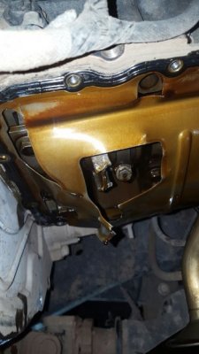

well the powder-forged connecting rods let loose...Snapped the rear most connecting rod most likely from lugging with the 5-spd. I never did noticeable lugging but I did use the Hemi torque to accelerate from 500rpm in 4th gear kinda often...I only revved over 5000rpm 3-4 times and 1 time with the clutch in on a shift it slowly revved to upper 5000's...that was about 400 miles ago. This was a 74,500mi OE build 5.7 from the best I can tell.
Anyways hypermileing for 17.2MPG comes at a cost I would say.
Considering a 6.4L Stroker for hauling and leaving cam, heads, and intake in stock form for idle-2500rpm power.
or H-beam rods...I'll need to tear into it later this week to see if the valves, piston and cylinder wall made it out ok.
