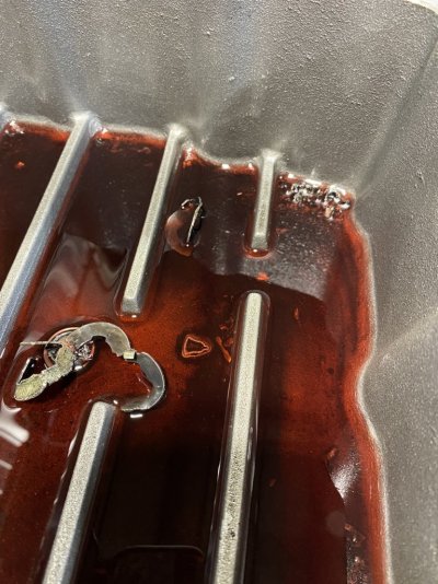

I am the original owner of an 08 Ram 1500... The transmission has always felt like mush to me. I’ve heard a whine when I drive it hard in 1st gear. I wish there was a way to tell the trans computer to shift firmer.
Jough Blough
Jul 23, 2022
8
Minnesota
2008
My 08 only has 108k on it. I changed the trans fluid at 80k. When I change the fluid, I found the factory had damaged the oil filter. It was mangled at the seam. Luckily for me my fluid was never lower than the seam… I didn’t think my fluid was bad, just knew it was 10 years old. My fluid didn’t look bad, smell bad and there was absolutely nothing in the pan that looked like clutch material. It still shifted like mush…
