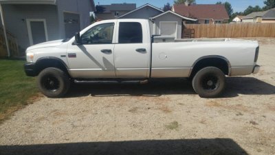

Its confirmed, 07 Cummins bolt pattern is the same as 08 hemi, best 25 bucks I've spent on a pickup0713181645.jpeg
