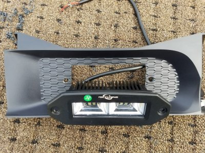

I dont think a 10" bar will fit in tow hook cover without serious alterations. These are 7", tow hook cover is 10" of flat space but there is only 2.5 or 3" behind cover from bumper bracket.
Thin pods may fit?

Its the mounting brackets for a 10" that will be a issue.
My pods are Mictuning, they make a SR Mini thats 8" so the brackets would have room to be bolted to the tow hook cover.
I did alot of research before deciding on flush mounts due to mounting issues with brackets as well as the limited clearance behind covers

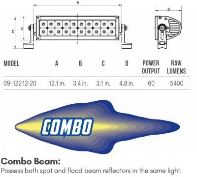

So lemme know what you think, the bottom bolt holes for the covers are spaced Right around 12.5". I'm thinking if I can get a bar with the same spacing it may hook up?

I'm thinking without the covers entirely
You will have to make custom mounting brackets, probably drilled into bumper bracket thats behind the covers im thinking. Good luck, let us know what and how you made them work
