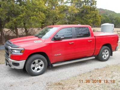

I always get a kick on folks who Mod up and run their trucks. Not something I would do, BUT each to their own. I think my stock 5.7 will do 14's, 16's, 20's, heck who knows, hee hee. U all be safe and enjoy modding yer rides................2019 truck new pic.JPG

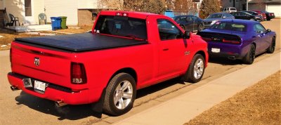

A quick truck that looks stock,will garner more attention at your local drag strip then a car will. My truck gets more attention at the local track then the Hellcats do,lol.Wife races the 1320 Challenger that's sitting ahead of my truck,and has more dragstrip passes under her belt then most guys do,lol

Rick----how many passes in the truck does she have---:D
Jay
About a dozen Jay,then she went and bought her old 16 5.7 Challenger,it turned out not being fast enough for her,so she bought the 1320,damn car is totally stock and beats my truck,not liking that much,lol. Car has went 11.90's a couple times now,at 3850 ft DA,which corrects to low 11.40's at 120 mph. For a stock 6.4,the car is way quicker then i thought it'd be,lol.Just ordered in another PCM for the car this morning,as i'm guessing by this time next year,she'll want it tuned,aarrgghh,lol.I still think her old B5 shaker hood car was prettier,i'm not a fan of purple cars,but her new one is quick enough,it's starting to grow on me,lol
