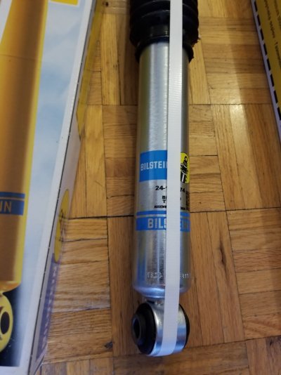

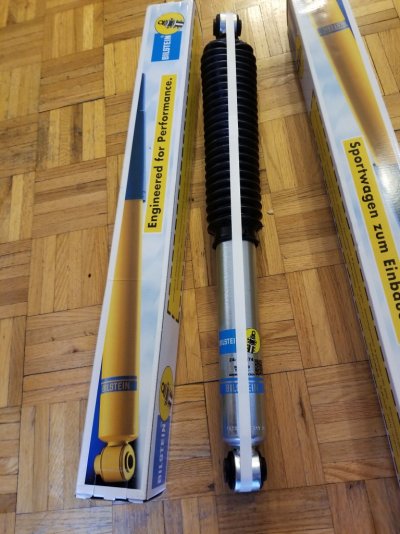

wow rock auto shipping to Canada is exceptionally fast this time! ordered friday morning was here at 1pm today!
faster and cheaper than amazon haha
will report back Saturday after I finish installing them. cant wait!!!
