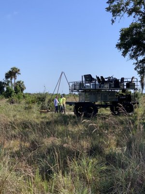

We have a swamp buggy thats been giving us overcharging issues. Dual battery setup-Blue tops, Napa/autozone standard Voltage regulator, and an old timer re manufactured Mastercraft 1g alternator.
idle is near 12+- volts and with RPM we peak on the meter at 16, but at the alternator we are putting out 17+.
it has fried a battery and swelled another.
brand new batteries and VR, no dice.
new Ground strap on VR and Alternator, no dice
New alternator, No dice
Rewire, No dice
We are going to attempt a one wire alternator with built in VR, but we arent sure what will happen.
We are eating up batteries and replacing voltage regulators to no avail.
anyone have any tips on overcharge issues?
Only a few LEDs and no sound, could power be under utilized? What about throwing on halogenlights and a fridge?
