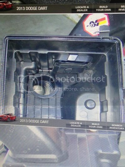

Im sure that I am not the first to do this, but I thought I would give it a try to see if there is any difference in AIT's / MPG gains at all. Plus it just gave me a reason to do something to my truck, and kill some time while working at the firehouse lol. I really don't want to spend 300+ $$$ on a S&B / Vararam ( not bashing ) just feel my money could be spent on other worth while mods to me. So for a grand total of 14$ spent I took a crack at it.
*** Pictures Below are not my exact work, this is what I used as the guide.
I had a K&N panel filter in my 2012, and swapped it into my 2013. I drilled a 3 inch hole into the bottom of the OEM Air Box ( Front Corner ). Went to the Hardware Store and bought some Flexible Aluminum Dryer Vent Ducting ( 4'' x 8' ).
Then I ran the ducting straight down along the inner fender molding ( I did trim some of the inner molding, not required just my preference. )
Then I routed the ducting to right behind were my tow hook would be located. Since I don't have any, I was ok and cut a section of the plastic grille thing and made it look similar to this.
I placed a dry rag over the hole in the air box, and used a leaf blower ( 3 feet away ) to see if I could get air moving in the box. I was able to get movement of the rag within the air box. Im sure the real world driving will be a little different, but it was worth the try.
Im taking a 200 mile round trip tonight / tomorrow so ill report if I see anykind of mpg gains ( if any ). So far my best trip in my 12' Express was 18.4 MPG. If I can break the 19 mark ill be happy lol.
I did disconnect the battery for 5 minutes to reset the pcm.

Did you close off the fender intake hole? If not, you'll want to.
Great job! I've done this in the past as well.

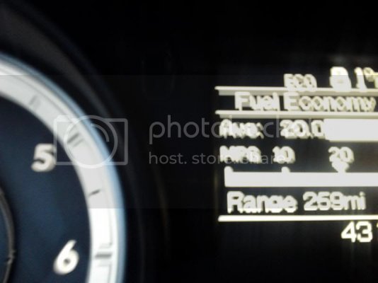

This is basically what my set up looks like. I took a 200 mile round trip Sunday night into Monday.
My Best Average MPG in my 12' Ram Express = 18.4 MPG
New Current Average MPG in my 13' Ram Express = 19.3 MPG
* Travel Conditions *
- Sunday 79 degrees / Monday 81 degrees ( Both Night Traveling ) No Rain.
- Windows up
- AC on Low / Max AC Temp
- Cruise Set @ 70 MPH
- Myself / Girlfriend / GF's Sister
- 263 Miles on Odometer @ start of trip.
Now I cant say for certain if the mod really made that much of a difference, or if its because my truck is brand new. I will hopefully be able to record another trip next month, and I will be well over the 1000 Mile Break In.
*** At one point during my trip I did hit an average of 20.0 MPG !!!! it lasted for about 5 minutes lol

If you don't close it off, then this mod is mostly for not. Any ram air effect you may have gotten will be lost by it going right out the other inlet.
Sure, if you're one that's fording rivers or streams, this mod isn't for you, but if you're going to do it, you may as well do it right.
As for heavy rain... Your engine CAN ingest water and many high HP motors have water injection to cool the upper cylinder area. My G8 sucks air from right behind the grill and it's level with the plenum, and I guarantee you it's seen its fair share of rain and snow and I've NEVER had an issue. Large amounts of water is where the issue comes in.

Yeah, but the air coming from the inner fender is going to be pretty cool... At least compared to an open element intake like K&N's.
The more ram air effect you can get, the better the better. I'm sure this setup gets you little effect, but it doesn't hurt either.

I figured for how cheap it was, I would give it a shot. I know its not getting the full " Ram Air " effect that your talking about, but the main goal was to see if my air intake temps would drop just a little. As we all know the cooler the air charge the better the engine will perform.
I have cut open my airbox before just to get the awesome intake sound, but this time wanted to see if I could actually improve on the OEM design. If I don't notice a change then no harm really done I guess.
