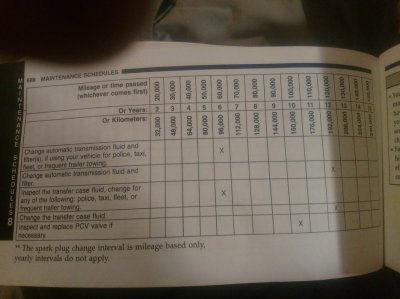

Manual says normal duty driving should be changed at 120k, severe or something like that should be 60k I believe. I'm doing it sooner, I just don't trust it to last that long. I've towed some but take it easy on it.

Manual pic for 2013 ram 6 speed

The manual wants the zf fluid which was standard the next year, that is real deal PAO fluid like Redline. But if you had it in your Ram it would be green on the dip stick. I wouldn't be going 120k on the pink stuff. Ram doesn't necessarily want your transmission to last past warranty, think about it. If they did they would have drain plugs and filters that can be changed easily like inline transmission filters, but they don't. They make it hard to change the fluid so guys don't do it and so they buy trucks more often, pure and simple.

The 545/65RFE trans calls for ATF+4, only the 8 speed calls for the zf fluid. ATF+4 is good fluid and will go 40-50k under moderate service with no issues. However changing the filters and fluid won't hurt anything, only help.

They must have had some 8 speeds or thought they would when they made the owners manual for 2013, yes the only fluid for the 6 speed is atf 4.

Yeah 2013 was the first year for the 8 speeds. From what I've heard about the 2013 8 speeds, I'm glad I opted for the 6 speed.
