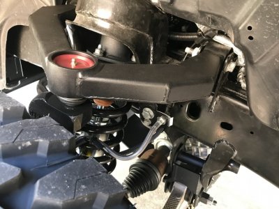

Just installed my zone 6/5 with bils and zones heavy duty UCAs, currently at the shop getting it aligned and they’re telling me they can’t get the caster right, said they have it completely maxed out. Anyone else have this problem? Ways to fix it?

No problems on my BDS, who installed the kit?
Are the UCAs on the correct side?

I installed the lift my self, just checked the ucas, I’m a idiot and they’re on the wrong side. I’ll swap them and get it realigned. Thanks for the help.
I figured that’s what the problem was, when you said castor.

Is there a quick and easy way to tell if they've been installed on the correct side?
