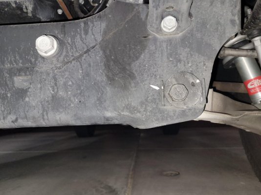

Pics of camber bolts. Driver was changed. Passenger stayed the same. Same song and dance now "Passenger is maxed out".
I have another appt to bring it back this week.

What state are you in?

I really suggest having the tech putting both camber bolts completely straight down at the 6 o clock position. This will be a good starting point to see how the camber differential rests. Then slightly and slowly twisting them to desired specs making sure neither are too far out of phase. Sometimes they get so focused on the spec they are ignoring on one side can counteract the other.
After 5 shops I am swapping out the Zone's today. Ill take it back and see if that fixes it. I went through all my old alignment sheets and their good until the Zone's went on. Ill report back.

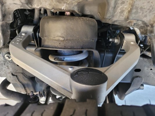

Zone upper arms
Eibach springs and struts at lowest setting
Alignment is fully in spec.

Zone upper arms
Thanks.
Those look close to mine yet mine isn't aligning. So, I am thinking quality control since the uppers have so many weld spots mine could be off. I have three other alignment sheets from three other people where theirs are also off. Maybe their uca are welded by hand and their off. Unknown.
After 3-5 shops not being able to align it I took the zone uca off last night and put a new manufacture on. The ride is much improved! Very noticeable. I take it back to the alignment shop today. Ill report back.
