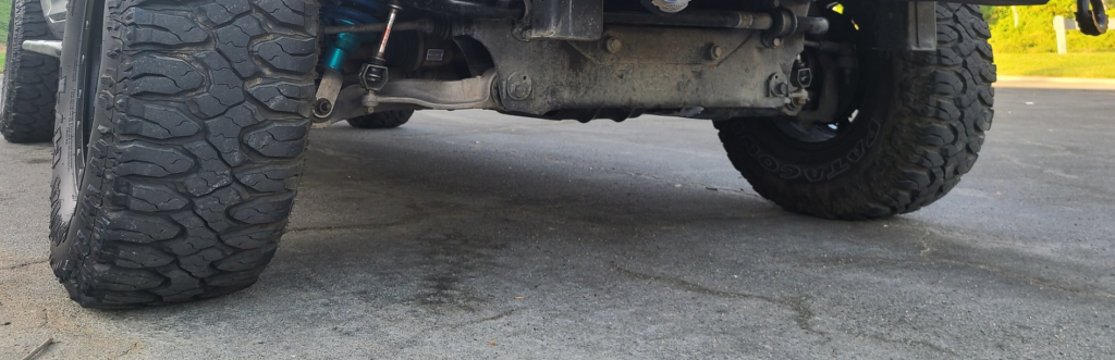

Ok. New saga in my truck life. I put Rough Country Vertex coil overs on. Went to a new alignment shop after. Making this my 5th shop now? Forget. They aligned it. Shop says the adjustments are maxed out. Best he could do. This is left pic of align. Fast fwd. I put Zone UCA on and took RC coil overs off and replaced with Eibach kit (struts and coils) front and rear. I take it to another shop. Only shop who could get me in before vacation trip. His alignment sheet is on the right. He says he worked on it for awhile. Its the best he could do. He ALSO says cam bolts are maxed. Second shop to say this. He blames Zone UCA because he sees no other reason why it wont get a better alignment. I asked him why people online on searches say their "alignment is good" I got the eye roll and asked to see their alignment sheets for which I had none to show. Are people using a camber/caster kit to achieve more caster and if so, which kit?
I included my alignment sheets from after RC coil overs (left side of pic) to after Eibach lift and Zone UCA (right side of pic comparison). I also included pics of the Zone to show their on right (I installed them). I also included cam bolts to show their maxed out. And lastly, I included a pic of a level against the tire. Why? Unknown. lol. I guess to see if the tire was level from alignment.

Did you check the UCAs we're installed correctly? There is a driver side and a passenger side.
Ya. I posted a pic above. I used a pic you had posted in a thread as a reference. I also took note how the BJ was on OE uca. The "short side" is to the rear or BJ is to the rear.

Odd thing too is its only the drivers side they can't get into specs. Both shops said maybe its cause the uca are new? One said maybe its the Zone uca. Thoughts?

Yep BJ to the rear of the truck sounds fine. Don't know what to tell you. The alignment is in range just don't know why the cam bolts don't look to be in a better position and why they cant zero out the driver side camber with that little caster. The caster correction is built into the arms so right of the bat installed caster should be higher than stock at the same lift.

I want to say no and blame the issue on whoever is trying to align the thing, the alignment is within range even though there is a red on the 2nd diagram. I'll still say ask for those cams to be moved. You can also contact Zone and see what they think
This is how my cams looked like when i had the Zones for example
And on my last alignment with the Icons
So you switched form Zone to Icon uca? If so, was the alignment better? Ill send an email to Zone on their thoughts.

Correct. But you can see its worse now. A new shop did this one. Same song and dance "its the best we can do", "its maxed". So, are the bushings failing or something shifting? I'm at a loss.

LF cam is maxed for sure. Rf is not. Does your truck pull left on flat road? The camber and toe angles make it look like it would, but will probably neutralize any right-pull from road crown. You're within specs so you shouldn't get any tire wear. If I was doing that alignment, I would push more camber on the right to even it out. Regardless, it's not bad. Are you having issues other than looking at the numbers on the sheets?
