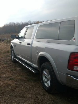

If the side steps a set off a 1500 w/ 6.4' bed, it will look like they're just for the toolbox as they have a separate step pad about a foot long behind the ones for the cab. They'll bolt up no problem as they mount the same as the truck with the 8' bed, there is no mounts behind the cab for the 6.4' or 8' wheel to wheel side steps.
This is a pic of mine (6.4' factory wheel to wheel)IMG_20161115_131455406-01.jpg

Pretty sure these steps are for the 5’ bed. They’re only 97” long total.
For size reference, mine are 107" long. To see how far back they go, the end of the side steps is 25" from the lower corner of the back door. The rear step pad is actually 15" long.
Crew Cabs w/6.4' beds are sort of rare in the 1500 trucks but if I remember correctly the 2500/3500 of the same configuration all use the same wheel to wheel side steps.
