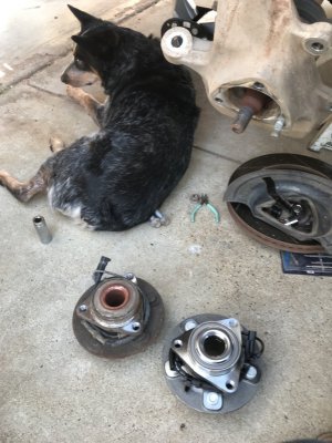

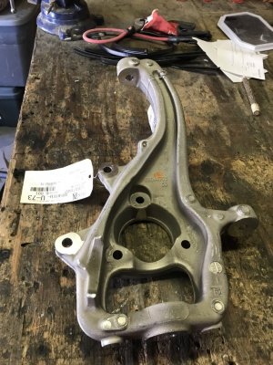

Wheel bearings at 86k miles. Also the driver side steering knuckle cracked during reassembly so replaced that as well.

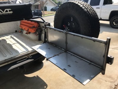

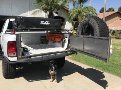

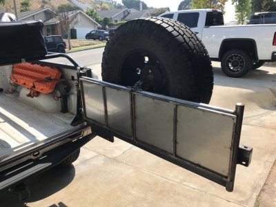

Please manufacture these. For all the sanity in the world there are so few aftermarket tire gate carriers for Rams. It’s disheartening.
Thank you sir. I’ll have to add up all the receipts for material and the time I spent on it to see if it would be worth making more of them.

Amazing build thread. I am totally floored. You could make a mint on those water tanks alone. Great work!!

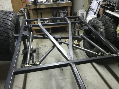

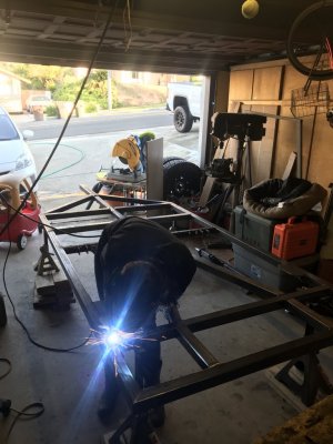

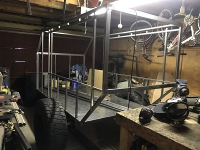

Well more of an accessory to the truck. Started the off road camper build. Yep built a 4 link for it, with the temporary Baja bug coil overs making 12” of articulated travel. Also teaching the girlfriend how to weld and have to say she is picking it up a lot faster than I did. The walls will go up after I register and get a plate for it, just need to make temporary fenders and put temporary lights on it first.
