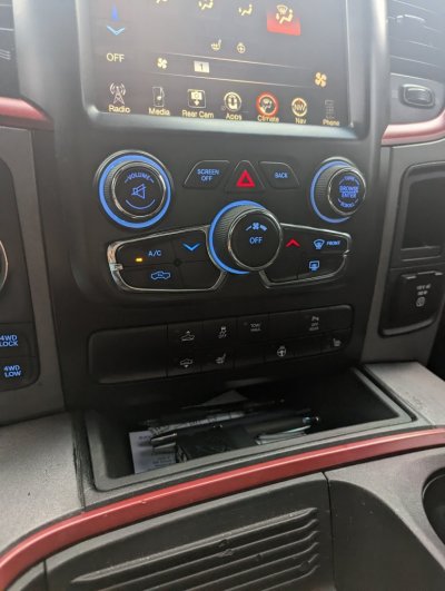

Strange bug happening, during the day it's not an issue but at night when i have the truck running the bottom panel on the dash just goes black (headed seats, steering wheel, air suspension control, etc)
I get the service air suspension DTC and i have had it come back on and the code disappear. Mind boggling

It isn't that hard to pull that panel off, although it is a bit scary. Might not be a bad idea to grab a phillips, and an 8mm, and check the connections on the back, before you start spending $. You should be able to get into that panel in about 5 min. I would recommend an impact, as a couple of the screws for me were... rather well installed.
Don't forget the one over the 110V port, and under the mat of the center console crap bin.
AND BE CAREFUL WITH THE 12V PORT! I broke the tabs on mine... Should just replace it with a QC 3.0 charger at this point, but don't want to figure out how to power the dash cam.
