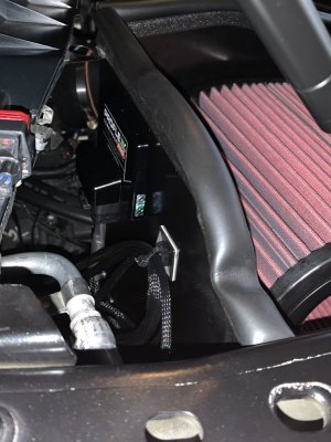

I can’t seem to get any help from vendors so I guess I will post a thread on it. I’m running a FBO 2.9 whipple right now on 8psi. I bought a Proflex Commander Pro made by Advance Fuel Dynamics. It’s a flex fuel system that piggybacks the injectors and uses their program module and a flex fuel sensor to command the right amount of fuel depending on ethanol content. I was also told it actually changes how the injectors spray fuel depending on ethanol content to help combustion.
I want to run at least E50-E60 but want to make sure I have enough fuel. I’m currently running Hellcat injectors and have a Kenne Boost a pump ordered. I also have Whipples upgraded duel rails. I was just curious if anyone has pushed the limits of the later 4th gens fuel pump. I think in 2015 or 2016 the fuel pump was upgraded.

I’m struggling with my Pro Flex at the moment. Leaning towards it being something in my tune. Was trouble shooting for about two hours earlier.

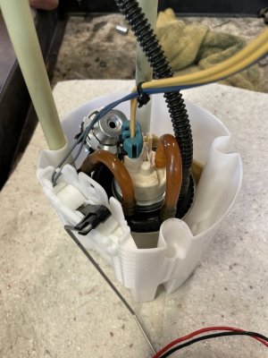

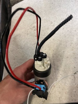

I have been able to modify the 4th gen fuel pump module to accept the Walbro 450's or the DW400 pump. It's not as easy to do like the 3rd gen 03-08 fuel pump modules. My crappiest install forced me to use a roll of aluminum foil to make the body of the pump fit inside the housing. The owner didn't/couldn't wait for the parts stores to open the next morning for me to correctly modify the pump or the housing.
The way that I have made this work many times was by taking the new pump to Lowe's and finding a piece of PVC pipe that was just too small for the pump to slide into. I cut a piece of the pvc pipe to half of the length of the pump. Then, I used my die grinder and my drill with sanding discs to make the PVC pipe inside diameter just large enough for the pump to press in.
Next, I shaved down the outside diameter of the PVC pipe to fit inside the original hole in the fuel pump module. I then connected the pump and filter and lines and I used epoxy to hold the assembly in place in the original hole in the basket.
My first Walbro 450 in a 4th gen fuel pump housing was done 4 years ago and it is still there to this day. Sometimes you have to be creative and let your imagination run wild.

Is it the container that holds the stock fuel pump the hang up I take it? I should have paid more attention when I dropped the tank to fix my fuel level sender. Just realized the replacement lasted longer than the original.
So the plastic holding the stock pump needs to be modified to hold the aftermarket pump? Check. I should order a stock replacement pump setup and an aftermarket pump. See what I can come up with. I wish I had more need around fuel system.
