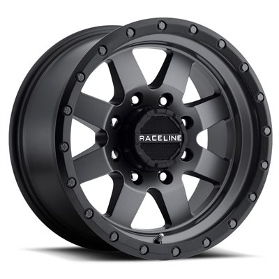

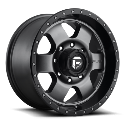

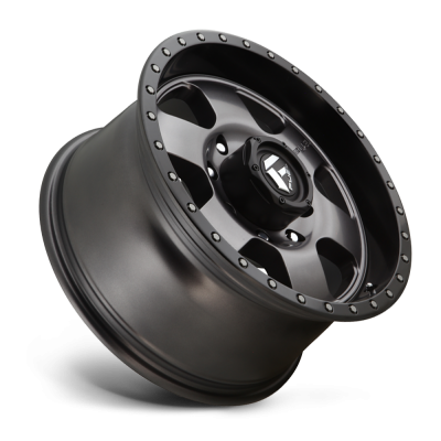

Going forward, I believe I'll be going with 17 or 18X9's and a 35X12.5 tire as I don't want to do any trimming nor want to change ring/pinion, at least for now. I do want the tire to be snow rated w/ the snow/mountain symbol but am not sure what is out there beside the Duratracs. Looking at Fuel Podium, Method 310/Con6 and Raceline 935G Defender wheels.
What is the general consensus on the ideal offset/back space? Also what is the bolt pattern? Thanks...:favorites13:

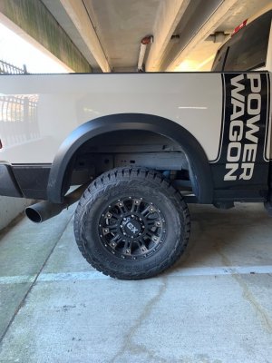

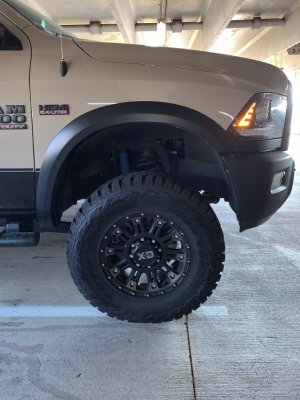

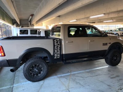

I installed KMC XD 18 x 9 with +18 offset wheels and Toyo RT 35x12.50R18s on my 2018 Power Wagon. I love the wider stance it gave the truck. The OEM wheels and tires look way too small and sucked in.
This is exactly the size I'm looking for when I order my wheels. Just not sure if I should go with 325's or 35's. Looks like the metric size has about a half an inch more width depending on the brand, and are within .5" for the measured rim width for a 18X9 wheel. See below for the specs on the Ridge Grapplers:
