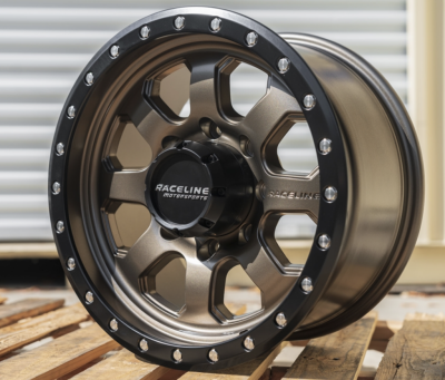

17 or 18X9's ? 35's w/18-20 Offset? Back spacing, Bolt Pattern Etc...

Well from what I understand the Fuel Podium wheels are only available in a +1 offset so I'll keep looking. Thinking about possibly going with 17" Racelines through CJC. 17X9 w/ +20mm offset. The bronze color might look real good with Max Steel:

I pulled the trigger on the wheels above yesterday. I'll probably go with the Nitto Ridge Grapplers in 35X12.50/17 with E load rating.

I installed KMC XD 18 x 9 with +18 offset wheels and Toyo RT 35x12.50R18s on my 2018 Power Wagon. I love the wider stance it gave the truck. The OEM wheels and tires look way too small and sucked in.

I love the wheel. They balance out perfect. The offset of +18 will put the tires almost to the end of the flairs. Just enough to keep all the dirt and mud slung under the fenders. I like the 18x9 size the 17s looked too small.

Thanks for the feedback. I'm definitely leaning that directly. For me it's down to the AEV Salta's or the Hoss 2 in 18s. I'm leaning towards the gray/black Hoss wheels though.
Any issues with rubbing with the 35s?

No issue at all with the decreased offset I get zero rub anywhere. There is a ton of room now to the control arms. I thought about even going to a wider 35x13.5xR18 tire but not sure if it will fit on a 9 inch wide rim. Most people put those on 10inch wide rims.
