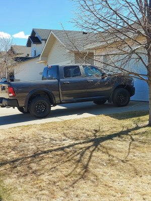

Post is useless without pics. lol This is the only one I have.

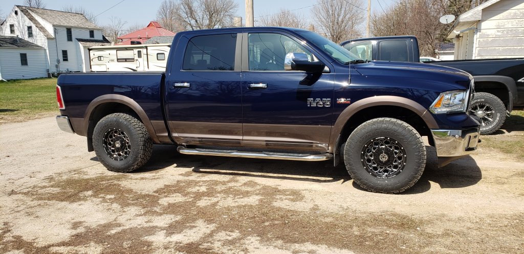

20210404_134443.jpg You can fit 285/75r17 on those wheels 34" tall tire. Some on here have put 305/70r17 on those wheels too with no issues. Here is mine with a 2" level 17x9 wheels & Toyo AT3 305/70r17.

View attachment 247086 You can fit 285/75r17 on those wheels 34" tall tire. Some on here have put 305/70r17 on those wheels too with no issues. Here is mine with a 2" level 17x9 wheels & Toyo AT3 305/70r17.
This. You can fit 285/75/17. If you level the front 315/70/17 will fit if you have the same backspace as the Rebels.

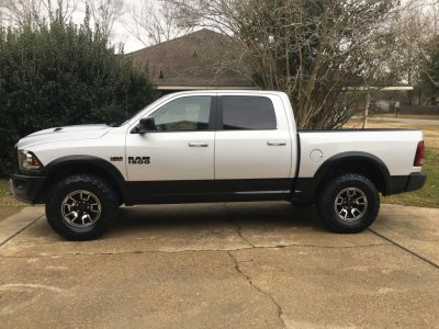

This dude fitted them in on factory Rebel wheels without issues. Back then he didn't have any level. Your truck should be 1" higher in the front compared to his. Your wheels should have the same specs as the Rebel ones. your suspension is literally the same as a Rebel. don't overthink too much because your 4wp shop said this or that. Find an Americas Tires local to you, they'll have much better prices that 4wp. They can test fit them for you no questions asked.
https://www.ramforum.com/threads/285-75-17-with-no-level.107546/
