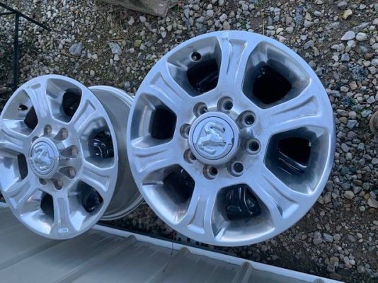

Out of curiosity, what is "cheap"? I found a set of 4 "new" 18 inch wheels off a 21 2500 for 400 bucks on Craigslist. Picking them up Saturday pending confirmation of the bolt circle (wheel comparator site says they are the same).
I'll be putting some highway tires on these and keeping the 17's and tires I have now for recreational use.
