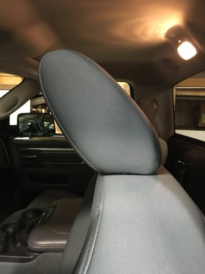

What would be my best bet to replace the cloth seats.My wife hates the headrests and they have no bells or whistles.We tried to bend them and the tricks didn’t change anything.IMG_2466.jpeg

If it’s just the headrests turn them around backwards. If you turn them around and switch the driver and passenger side they will retain the position locking detents in the correct spot.

Definitely worth a try will try it first thing tomorrow

When you reverse the headrests
They no longer tilt forward
They are directly in line with the seat back & so much more comfortable
I do not know how much difference there is between the Tradesman & BigHorn & Laramie Seat material & design pattern.
But all the headrests are leaning forward on all of them, until you turn them 180°
I do not have any pix of my reversed headrests, because i no longer am irritated by them
