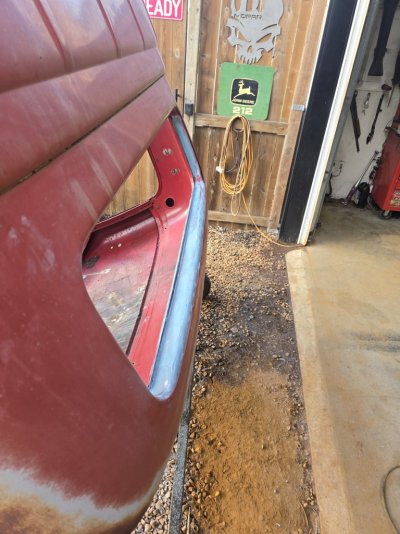

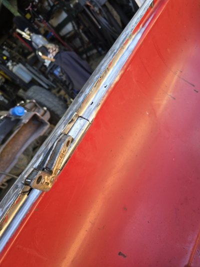

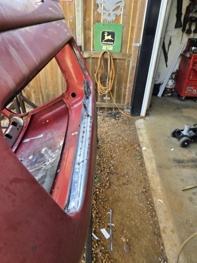

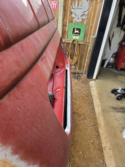

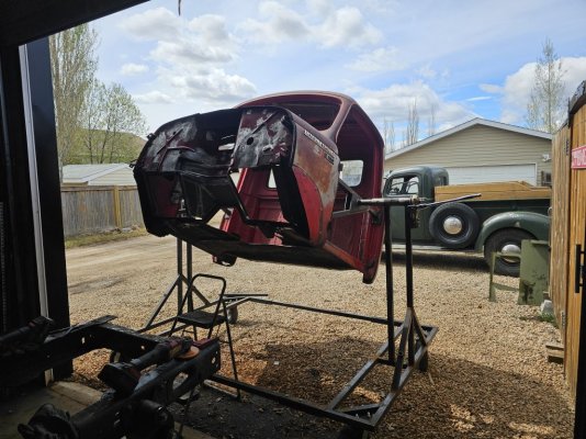

Got the other side done today. Doghouse is all squared up and ready for the removable cover.
Will finish the rest of the floor tomorrow. And start on the roof next .

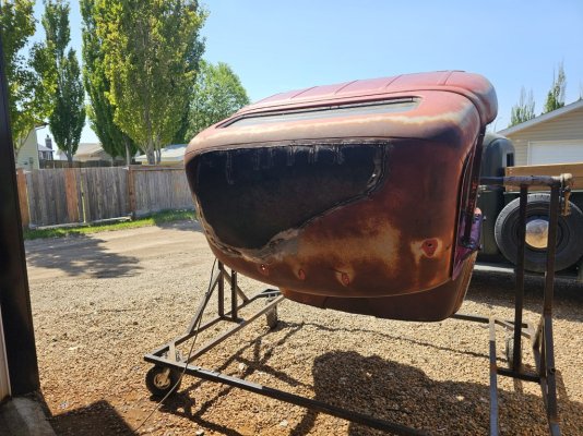

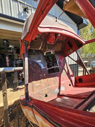

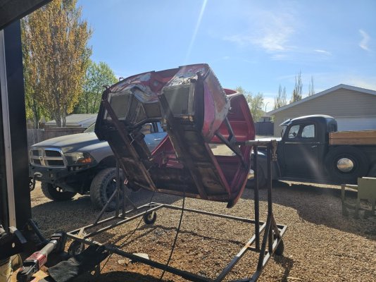

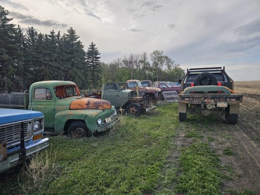

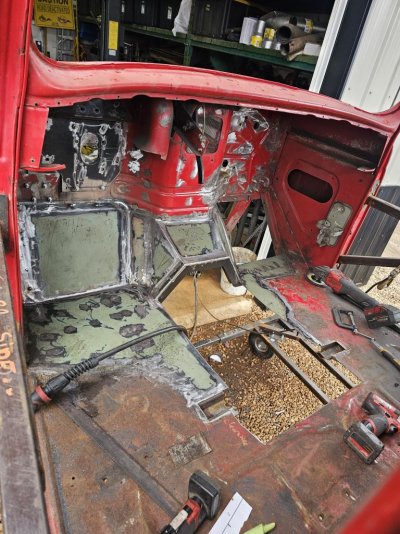

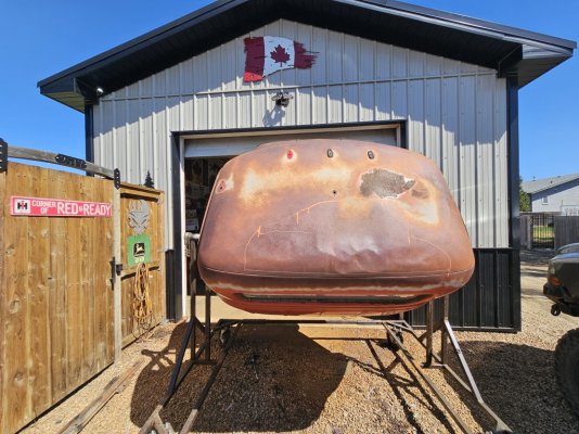

Finally done the floor. Tine to move on to the roof :yucky:. Good thing I know we're 12 International trucks are hidding. Will just go cut a roof off one of them . :peace:

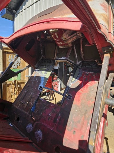

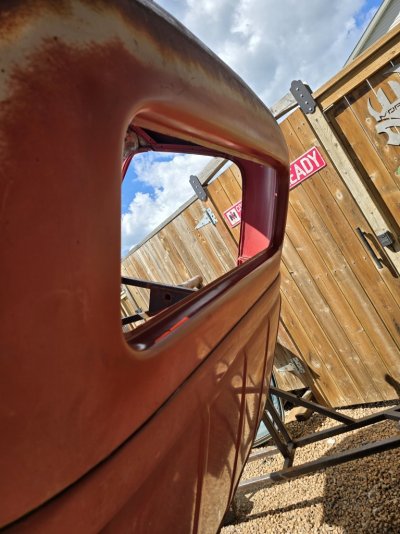

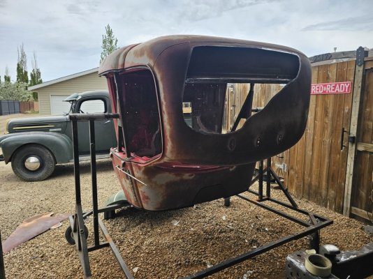

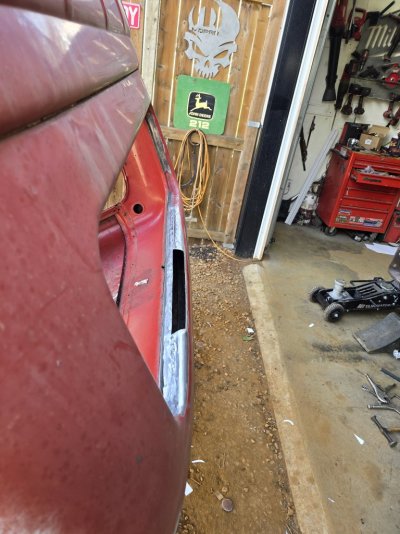

It's as hot as 2 rats fucxing in a wool sock this afternoon. This is as far as I got. Only warped in one spot so I relief cut it and will stich it tomorrow. I wish I had a spot welder to pull the welds out were I don't have access from inside the cab for my hammer and dolley. . So my slide hammer and self tapping screws had to do.
I don't like using more than 1/16 to 1/8 of Metal-2-Metal , so I got a fair bit of dolley and hammer tommorow as well.

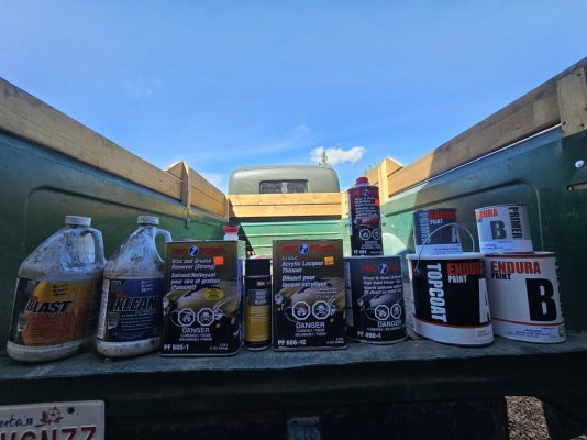

I can't believe this cost me almost 1300$ in Kenuckistan pesos and I had the KBS stuff on hand.

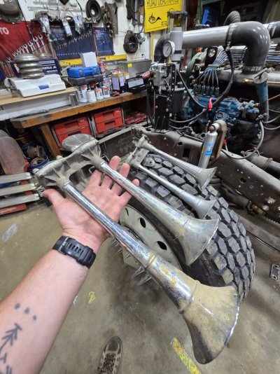

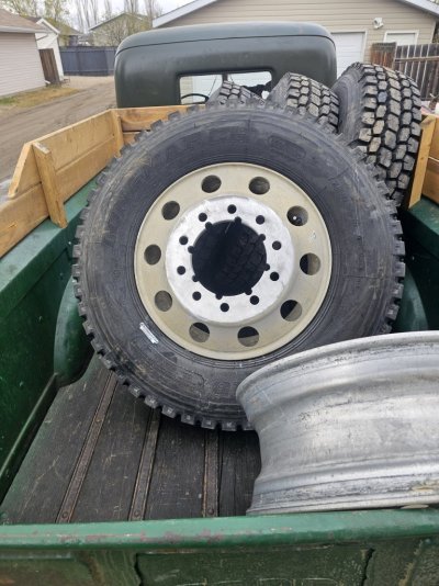

My 60$ eBay find. The exact same as the one set that was on my R190 when I got it.
I didn't like how it look with just one set on the driver side. ;) Now everything will be cemetrical.

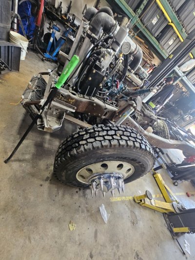

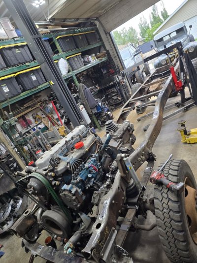

Got everything stripped off the frame. Pulling Engine tomorrow and building a proper DT360 engine stand :evillol::headbang:
Once that's done I'm bringing my frame to my buddies heavy duty shop to finally install the Neway Air ride rear-end , sandblast and paint this bi!TCH
