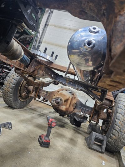

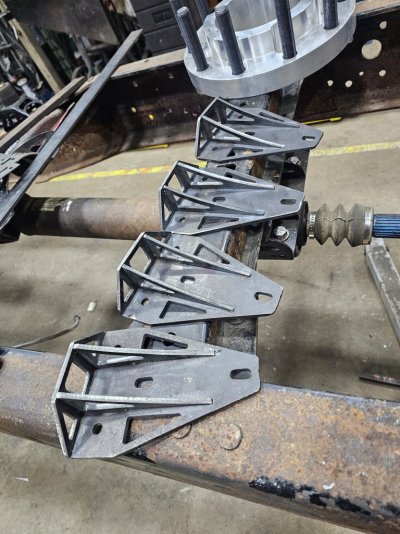

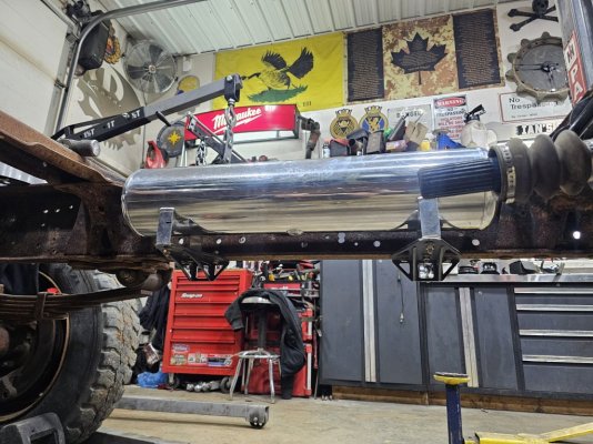

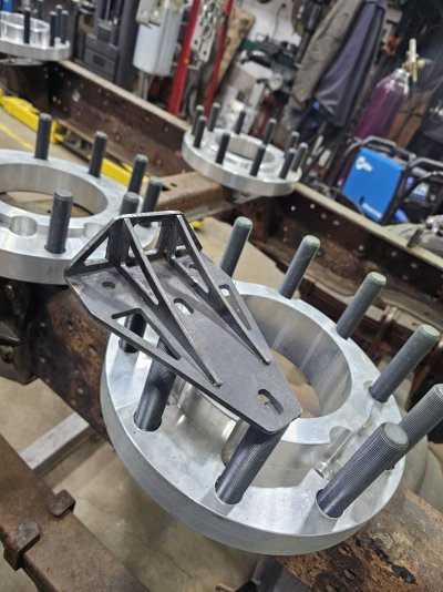

Brackets worked out great.

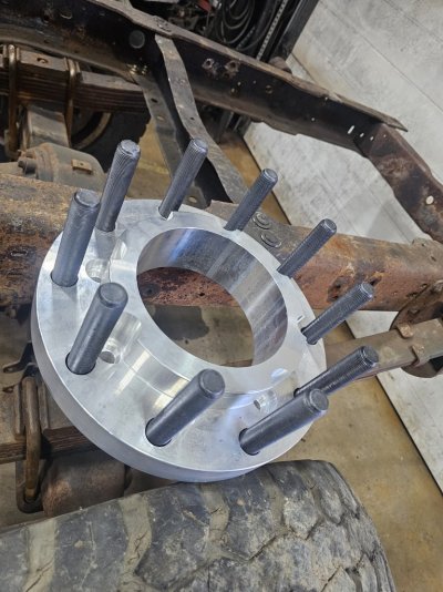

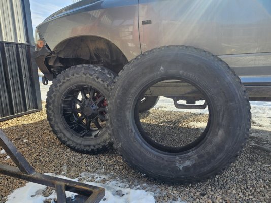

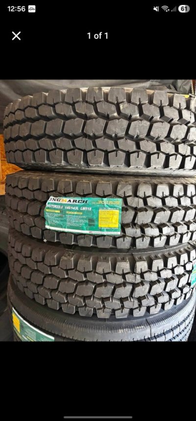

Dropped off the Alcoas to get notched and picking up some 295/75R22.5 tires in Edmonton Tommorow before prices go up again. They are only 250 a tire :peace:
The Rat Rod will be on 40s :cool:

My buddy lent me his new Ram with the hurricane engine to go to Edmonton to pick up my tires.
I'm surprised I didn't get a ticket :cool: still blown away about 27 PSI for oil pressure.
Those 40s beside my 37s make them look like child tires

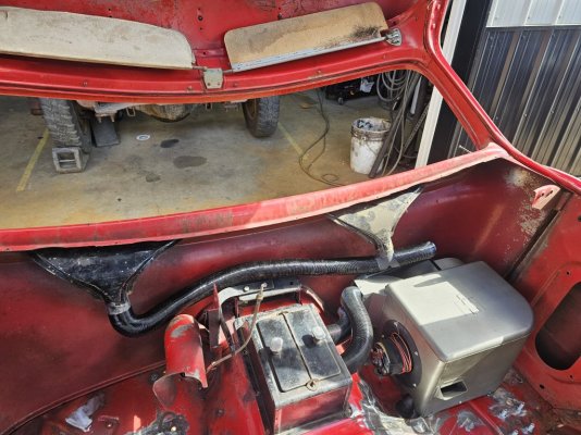

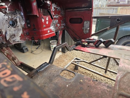

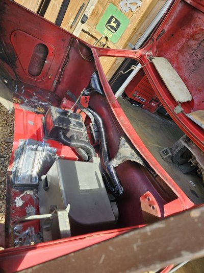

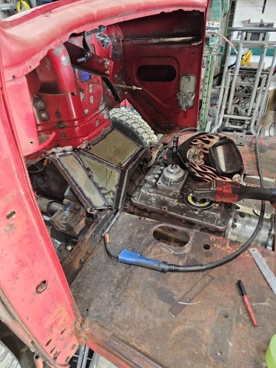

Finally figured everything out to fit my 1961 IH 12v heater in a 1960 :hat:
Nothing some vevor diesel heater hose and adapters couldn't fix. ;):peace:
Now back to plugging holes on the cab

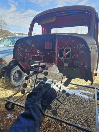

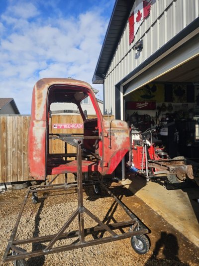

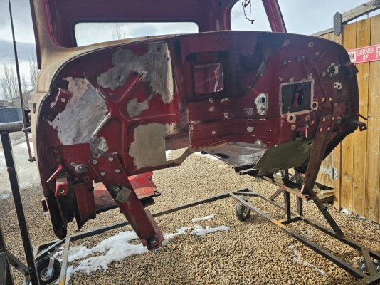

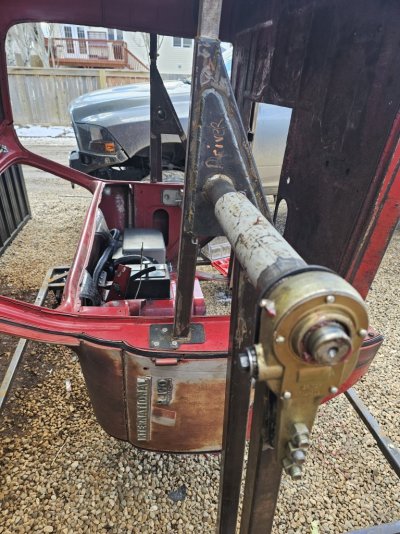

Do those air brake slack adjusters (they look like ones off S cam air brakes) allow you to position the cab at different angles?
Yup, I built a man size rotisserie :dogpile: , I saw this video a while back and said to myself if it works with an engine it would work on a Cab. https://www.youtube.com/watch?v=vDEpVvYgEiI
I will be adding one to my engine stand as well :anitoof: , they are only 35$ for the Adjuster and 38$ for the S Cam.

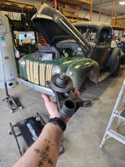

Changing the water pumps on my 46 today the orinals ones only lasted 33xxx miles.
