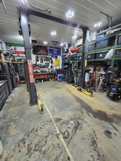

Plenty of room now , everything is at my buddies place:evillol:.
Putting the sh!tbox on the lift today, it's been a year already and it's time for it's oil change and making sure nothing is broken.

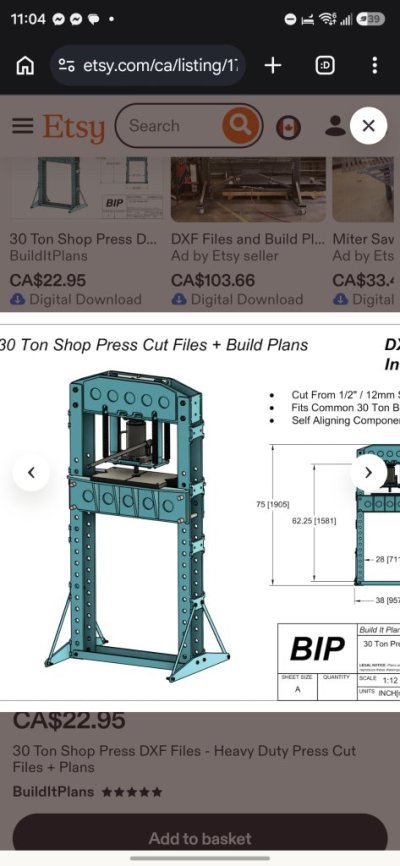

This is the new one , all cut on the plasma ;) spend 400 to save 200 best guy math ever.
