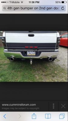

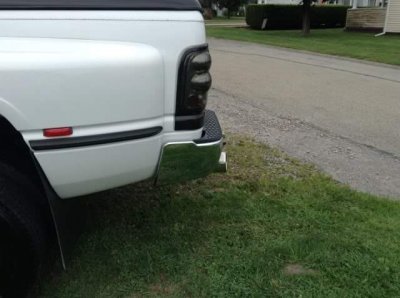

A simple tape measure will probably tell you what you won't want to hear. I think you will find the 2009 and newer bumpers are shorter than the 2nd gens. The 2nd gens rear bumpers stick out past the bed side - on the newer ones the ends are recessed in a pocket. I kinda recall a buddy wanting to do the swap, and it would have either taken widening the 2009 style bumper or adding the pockets into the lower bed corners for the bumpers to tuck into.

The pics don't lie! It might have been a 3rd gen he tried. It was quite a few years ago. I just kinda remember him talking about not wanting to cut the pockets into his good box lowers.

Hey man, thanks for the pics. You make a good point about the 2009 and later Rams having pockets in the lower section of the quarters. Thats a show stopper for me. I can machine most anything, so fab'ing mounting brackets is gravy; but body work is not for me. Looks like duals under the bumper or I leave the single side tailpipe and spend the savings on beer. Clint Eastwood said, " A man has got to know his limitations." Thanks.

Yeah on a truck that isnt a dually it kinda pokes out. Fender flares can minimize it quite a bit though if you ever wanted to put those on
