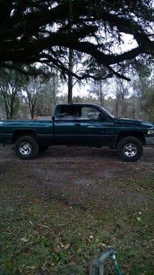

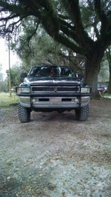

So I bought a truck to fix up. This is my first 4wd and the first time I have purchased a vehicle I didn't need to get on the road tomorrow, so I want to take this opportunity to do it right. But first a little backround on the truck and myself.
The truck: I purchased a 1999 ram 1500 5.9 4wd 4 door automatic with 235k miles in fair condition. Truck runs and drives mostly as it should but isn’t without its list of things to be addressed. I have already done a few things, new battery, starter, plugs wires cap and button, and charged the AC. I swapped some cosmetic parts from my 96 dodge, rear tail lights, rear bumper, and Reese hitch, due to a minor accident that bent/broke those parts and the tail gate.
About me: I am a 31 yo paramedic with some mechanical background and some tools. I am really good at thinking I know what I'm doing and completely screwing it up. I live in North Florida, and spend lots of time in the woods exploring and looking for new fishing spots, and occasionally find myself out and about when the roads are muddy, and I’ve had to be pulled out my fair share, hence the upgrade to 4wd.
So my next major project with this truck is to address an issue with the front end, and this is where I need your help!
The R front tire is in terrible shape, uneven wear and bald spots, its possibly the worse tire I've ever seen hold air. I’m sure the cause is in the front end somewhere.
What I would like to do is replace everything up there, ball joints tie rods, that kinda stuff. But I didn’t know if this was overkill, I just don’t want to fix broken/bent part A, then have to take it all apart in 6 months to replace parts B C and D that hadn’t failed yet but I wasn’t paying enough attention to notice were in poor condition.
If anyone could offer advice as to what should be replace ideally, what to look for, and maybe a parts list, that would be great!
I apologize for the super long post, but I’m hoping to inspire someone to assist me on my quest to build a beast of a truck...
PS... I am also looking for suggestions on the following
Shocks (curent are stock, and terrible)
Tires (current 285/75/16 m/t and overdue for replacement)
exhaust (current is stock and too quiet)
cold air intake (is it worth it)
vinyl floor install (how hard can it be?)

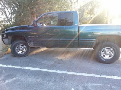

Ok so been working more than your average human and got kinda behind. I did get the step bars put on and finaly got to go around the truck and get some pics of its current condition.
