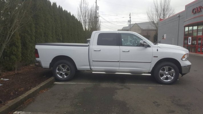

I have 39.75 from ground to fender in rear and 36.25 in front. 3.5 inches of rake. so am I measuring correctly. And if so do I go 2.8. 1" of rake I can deal with but I do not want nose higher then rear. I shter another way to check to be more accurate? thanks and MERRY CHRISTMAS

Those are about the same measurements I had. I think my rear was 39.5". I did the 2.8" and have a 1" rake. I really like how it looks now and it drives/rides great.

Those are my exact dimensions. I am having my Bils installed Thursday at 2.1. Went 2.1 to reduce chances of UCA issues.

Those are very close to what my dimensions s were as well. I installed the bils at 2.8 and was slightly nose high measurement wise, but looks wise it appeared even more nose high. So I put in tgc 1" rear spacers and had just a pinch of measured rake but it looked dead flat. Well, over time the bils have settled a bit and now I have about 1.5" of rake. A bit more than I would've liked, but I've decided to leave it be. I think the safe bet is set them at 2.1" if you want level and not mess with the rears. If I did it over again, that'd be the route I'd take.

thanks I am thinking that would be the safest to start knowing I could raise if needed to 2.8" Just went out and measured again only to find the front drivers and passengers measurements are a 1/4" apart. 32" and 31 3/4" but my rears are 33 3/4" and 34 5/8" so with that being said 2.1 to be safe with 285-65-20 ko2s to start. this is my first dodge and I already have a mod list going.thanks for any help with this. I will post pics and mod list just have to figure out how on my profile. again MERRY CHRISTMAS

Bils @ 2.1 in front. Bils in rear , no spacers.
I miss the softer OEM ride a little but it handles a bit better, there is no body roll now and it looks good.
I don't off road so no feedback on difference.
I still have 1.25" rake.

I've been running the Bilstein 5100s @ +2.8" for approximately 26,000 miles . Zero issues so far , I 4 wheel often and sometimes pretty rough .

My front is leveled at 2.1 and running 285/65r20 Nitto Terra Grapplers G2 on stock wheels ...no issues, love the ride.

When going with the 2.8 it may appear to look nose high just from the design of the body. Even though the measurements may in fact say you have rake. That's why most do the rear spacer when setting the BS's at 2.8". I did the 2.1 simply to avoid the rear spacer. I love the way it handles and looks. My measurements show I have a 1.5 of rake but looks level (due to body design). But all in all I'd base it off of how you use your truck.

my measurement are 36.75 and 39 rear. At 2.8 front will be 39.50 and with 1" rear spacer I will be at 40" so I am guessing .50-.75 rake. does this sound about right. I am assuming 2.75 out of the bills at 2.8.

I will take some to post.
