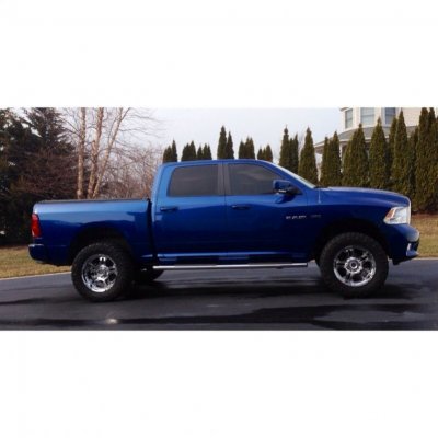

Three inch body lift on my 09 ram. Can't wait to do it on my 14 ram
