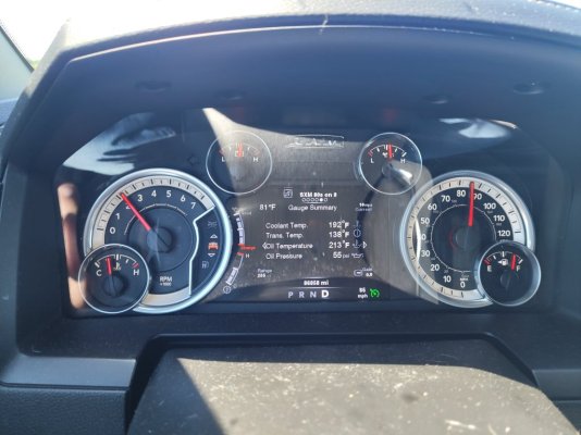

Questions for those that have the two quart extended pan from PPE.
How much did it drop your transmission temp?
Did you have any trouble making it fit with your exhaust?
Reason I ask, I got offered a new Uninstalled one with 2 extra filters for a great price and am considering.
Now my 14 RT doesn't run hot, I have the Chaulk04 valve installed and am worried about over cooling.
My 2024 1500 classic is under warranty and doesn't need it. Yet. But I know I will not let it sit around if I purchase. I changed the pan and fluid in my RT about 20k ago. My 24 has 12k miles, so not an issue.
Feedback from those that have taken the plunge. My 14RT at speed, trans temp picture below

It'll drop your temps probably about 6/7 degrees .Where you are,you might want to look into a stand alone thermostat from somewhere like Improved Racing.
I can't comment on fitment,as i didn't put the deep pan on until after i had long tubes,so i never had to contend with the cross over pipe under the pan,but it supposedly will fit with a stock exhaust.

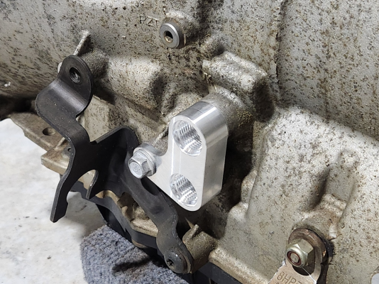

A guy by the name of Ryan Janocko over on the ZF Swap page is building these adapters,that delete everything off the side of the trucks transmission Big,and allow you to just use a normal NPT fitting,beats having to tap the case that's for sure

Wild One, says video not available anymore. I don't have zuckbook, is there any other contact info on that adapter?

If you Google search the name and Facebook it brings up a second video on the unit
I love when people come up with clean simple solutions.
