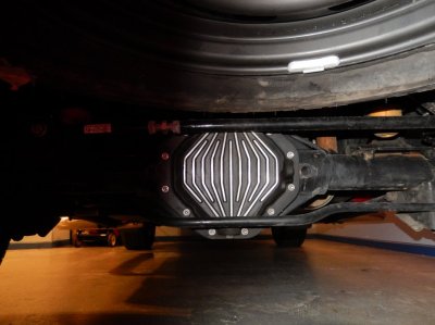

Could someone do me a favor and post a pic of your panhard bar with a 2 inch drop before I go ahead and order the springs. I want to see just how far off it is.
Thanks

Thanks. That is what I wanted to see. Looks like you can drill new holes to realign panhard bar.

I did the 2" drop and then redrilled the hole for the panhard on the frame, that brought the bar back to level.

Good thread. I need to recheck mine after work. I think it was close enough that we weren't concerned about it.
I've not changed the panhard mount at all and NEVER had a wiggle. In fact, I've not measured but the wheels still appear centered in the wheel wells.
