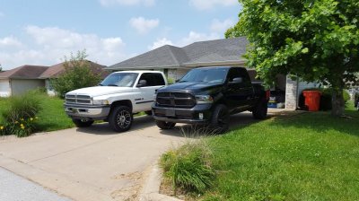

Thought about going oem 20s on mine, but decided I liked the look of these on mine.
