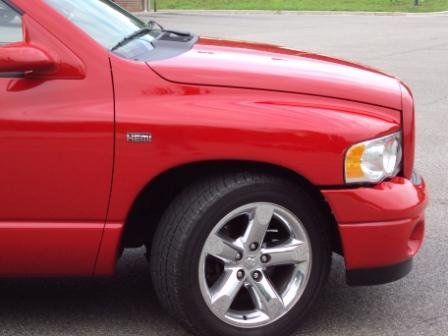

This is the 06 SLT aluminum wheel with plastic cladding I was referring to. Post a picture of what you are talking about.
Those are my exact wheels. The reason i'm asking,is I want to buy new tires but there is a few blemishes on my current wheels. So I THOUGHT and was hoping to buy new chrome plastic "hub caps" so my wheels would be like new. The reason of my concern is 35x12.5x20 tires are like $1500 and then the same size but in 17" are $100 less. I thought 20's were way more then 17's. So I figured since its only $100 more total for all 4 tires in 20's I might as well get new hub caps since I actually like these wheels. If and since now that I will switch to 17's i'm looking at forking out $2400 one time for wheels and tires,and there on after only saving $100 a tire purchase. If i'm buying new wheels I wont buy stock ones unless they are dirt cheap and flawless.

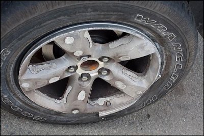

mrfyram1500
2024 1500 Laramie
Jan 20, 2012
209
34
Ohio
There was a pic floating around of one of the clad wheels without the cladding. They are glued on to the alloy wheel. I didn't like the look. I haven't seen any replacement covers.
