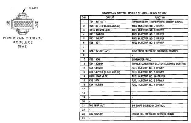

If it is not loose connections in the splices and a problem with the actual connector being broken, Wells Vehicle Electronics makes new ones. WVE Website to include part number: https://wellsve.com/parts-search/?partNumber=1P4068 You may be able to contact them or search for a retailer. Looks like Rock Auto and perhaps O'Reilly's were both selling them, but currently have none available. Wells Electronics may be able to direct you to a retailer.
