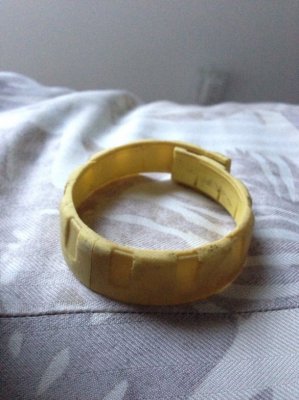

This exact problem happened on my 2004 hemi, the IAC needed to be replaced, also check if the throttle body needs to be cleaned.
