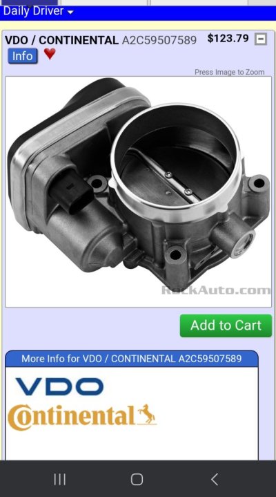

BTW:
This is the TB you should have bought.
It's made by the OEM.
Available at Rock Auto.
