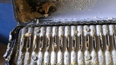

Calcium Plugged Radiator was the problem. Also found a cracked water-pump impeller during troubleshooting.
The symptoms was only overheating on FL turnpike 70+ MPH.
Solution, dont use tap water!

Pried apart my radiator covers reveals why not to use tap water...

Tap water + heat = bad things. :)
A good lesson for all.
To those who still don't think it matters: When the service manual calls for distilled water - this is why.
