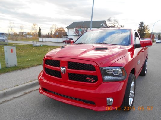

Being in Colorado i'd try a 192 thermostat,as it'll still supply good heat for the winter,and won't cause any issues,a 180 "might" turn on a thermostat rational code,but that's a big "might" as i've ran lots of 180's with the stock tune and never had any issues with codes.Or you could do like me and swap between a 180 for the summer,and then stick either a 192 or the stock 203 t-stat back in for the winter. As mentioned by Cory/Hemi395 what grill do you have,as the grill can make a huge differance on airflow
You want the Honeycomb grill,you don't want the slat/Sport type grill.
Pictures of both,the grill you don't want is the 2nd picture
