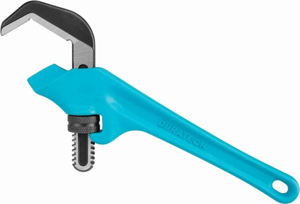

Wait til he is on the road, yeah thanks alot, lol. Maybe he'll drive near a harbor freight, cheap enough, at least here in the states.
Hex Monkey wrench, will take care of most nuts and give torque. Every truck needs one. Unless I am wrong, I think all sizes have the same opening, which means go small 9 inch and have a steel bar if you need some extra torque. And big crescent as well, but you will grab this one more.
That's a bit big and rough for grill removal Mike :Big Laugh: . If he's going on a 2500 mile trip,and he's already had over heating issues,he should hopefully of took a toolbox full of some tools ,and a couple jugs of water or pre-mixed coolant with him,i know i would,as that's just common sense:waytogo::Big Laugh:
