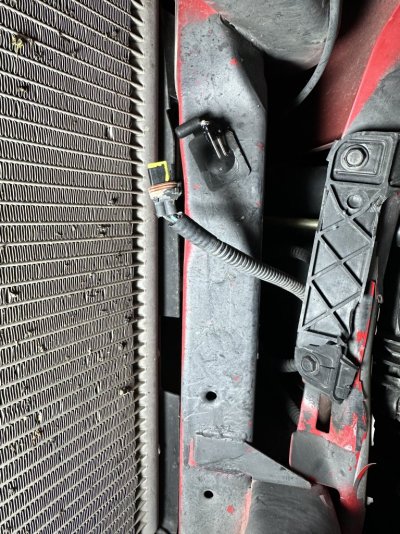

Anyone have a picture the ambient air temp sensor on a gen 3? Service manual says its bolted to the underside of the hood, but I don't see anything beside the hood lamp. No other wires running to the hood. I don't see anything resembling that sensor. All I can find is the sensor that went in the stock air box.

2002 it's on the underside of the hood, 03-08 on the driver's headlight. Aftermarket headlights don't have the cutout on the one screw hole for the sensor to mount. When I replaced mine I had to dremel that spot flat to match OEM.

Thanks for the photo. That's where I put my new sensor. My pigtail is shot though. That's today's project.

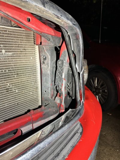

Did you have any troubles replacing with a damaged pig tail? I'm trying to replace mine after I hit a deer; not sure if I should just cut this and try to solder wires back? Any advice out there would be greatly appreciated. 2023-11-20_18-42-44_192.jpeg
