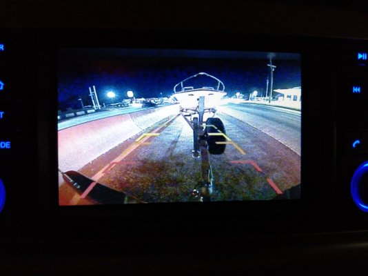

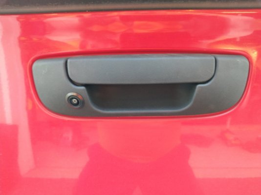

Tailgate handle with cam - https://tailgatecamera.com/collections/2002-2008-dodge-ram/products/dodge-ram

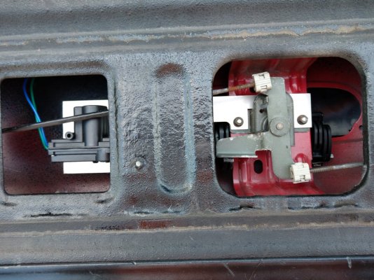

Power lock - https://www.americantrucks.com/pace-edwards-powergate-tailgate-lock-0208-ram-1500-ram.html

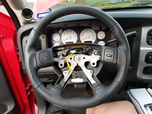

Unfortunately the Grant wheel only comes in dark/slate gray (Grant actually says it's black) - https://www.summitracing.com/parts/grt-64037 Maybe it can be dyed?
