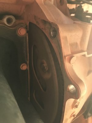

john p f
john p f
Dec 26, 2017
116
25
Oklahoma
2006
Torque converter bolts were snug. I tightened them just a little more. None rattled out or anything.
