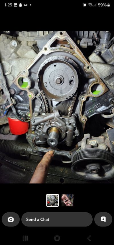

The valve covers were leaking oil already so I ordered new gaskets and changed them. While I had the covers off, I turned the engine all the way through and it appeared that all rockers were performing as normal and obviously my chain hadn't broke since I was able to turn the engine over and over.

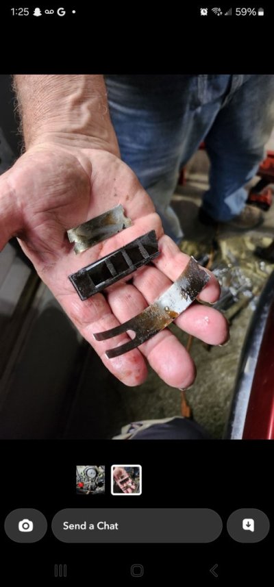

So I get the accessories all stripped off and get the cover off. I immediately see that chain is fine but the tensioner had broke. I was able to fish out all the pieces as well. (See attached pictures)
I got cylinder 1 to tpc and then proceeded to pull off the oil pump and then the sprockets and chain. I replaced all of it with new oem parts. Camshaft sproket was at 12 and crank was at 2 as per the manual. I reinstalled everything back to how it was.
All gaskets replaced with timing cover as well.
I replaced the oil pump and water pump since I had it all easily available.
I replaced both crankshaft sensor and camshaft sensor with oem.
Got the belt back on and tried to fire it up before installing the coolant components just in case I had to get back in and all it does is spin. Doesn't fire up, just spins.
I got underneath and hear my fuel pump going. I've checked all fuses and they are good. Battery is fully charged up and I get nothing.
