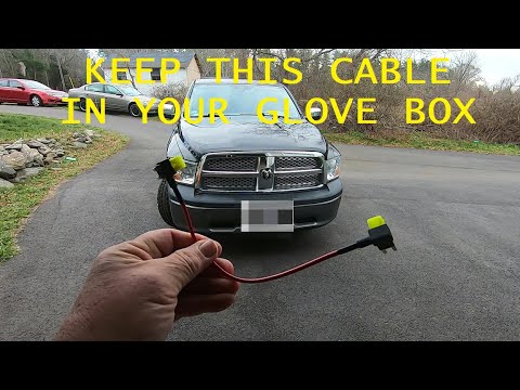

In leu of that would be to narrow it down to either spark or fuel. For fuel, perhaps try pulse-squirting some starting fluid into the throttle body when it goes to 'die' ...to see if pulsing some starting fluid will keep the engine running for a bit longer (which would then point back to a fuel issue). It would be good to check fuel pressures and the pressure regulator. Fuel pump relay is another issue (was somewhat common on these years). The fuel pump relay is on the main TIPM (computer) board, some guys replace. Seems strange such a problem could occur right now, but there's a cheap bypass cable you could try.
