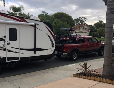

I recently bought a 2010 3500 to tow my toy hauler and toys to the desert, camping, etc. Friggen love the truck, when it's fully loaded and smoothed out. Empty driving is a bit different. I get the trade off, a 1 ton is stiff to handle the load.
It has Bilstein shocks and I installed an AirLift system in the rear for extra sway and leveling control.
With all that, can I soften the ride around town? I heard someone suggest swapping to a 2019 Air Ride setup but not sure if that can be done on a 2010, what the cost would be, etc.
