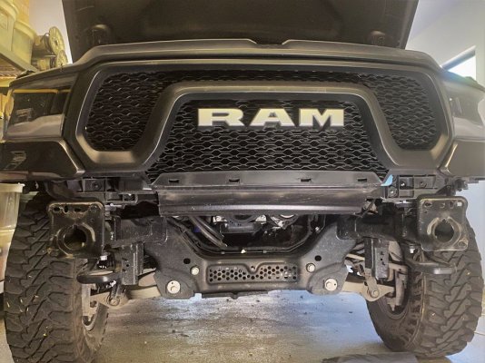

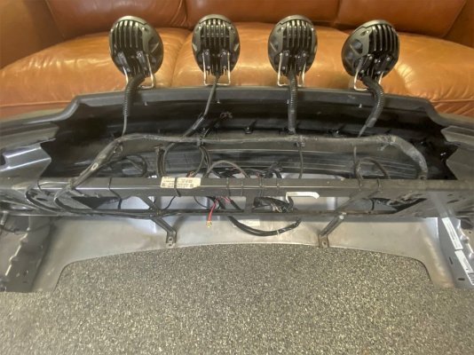

Well, it's been a while due to my hectic work and travel schedule, but finally decided to replace my silver Rebel skid plate with my new powder coated replacement skid plate. I had decided to split the difference between the silver and black selections of my survey (where results favored the black skid plate) by going with a gun metal grey color and glad I did! I think this color better suites the overall color scheme of the truck.
First off, I decided that all I wanted to do this weekend was get the new skid plate installed as seeing my self-inflicted damaged skid plate every day (from bouncing around in the desert several months back) was driving me crazy. I didn't have time to do the full hidden winch install since that would have necessitated another day without the ability to use the truck, but I can add the winch anytime (especially since I now know what it takes to remove the whole bumper).
I also imagined that it would be a simple job to just unbolt the skid plate and replace, so I initially didn't bother taking off the entire bumper. While I spent a couple of hours prepping and getting most of the bolts undone, I could not remove the skid plate as there are additional bolts that are hidden and cannot be accessed unless you remove the whole bumper assembly. And that stressed me some more as I had to undo all of my off-road lights' electrical connections as well which added more time to my simple project. I finally got the bumper off (after dealing with the lights, loosening the wheel well fender liners, disconnecting the front bumper wiring harness, and removing the 6 frame mount nuts of which 2 were not easy to do). So, I wasted a half-day in the process.
Damaged plate:
Bumper removed:

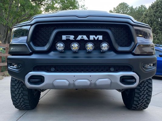

All done for now until I get the hidden winch installed; the change is subtle, but I think looks perfect with the color scheme.

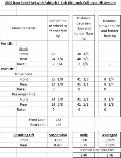

@Desert Dawg, I know you posted your pre and post lift ground to fender heights somewhere but I cannot find them. I have had my new Rebel for a month and half now and I am still trying to figure out what to do for a lift/level solution. I just read your Dirt logics settled more and I am curious of what your current ride heights are sitting at.
THnaks,
Desert Dawg
Desert Dawg
Apr 4, 2015
178
361
Albuquerque, NM
2020 Ram 1500 Rebel 4x4
THnaks,
Hi there @Racing Woody; sorry for the delay in getting back to you but been away on travel and work.
Here are my initial measurements after the lift install:
I just measured the driver side and I am now sitting at about 40-15/16 so the front has settled almost 1/2-inch over the past 2.5 years of use.
