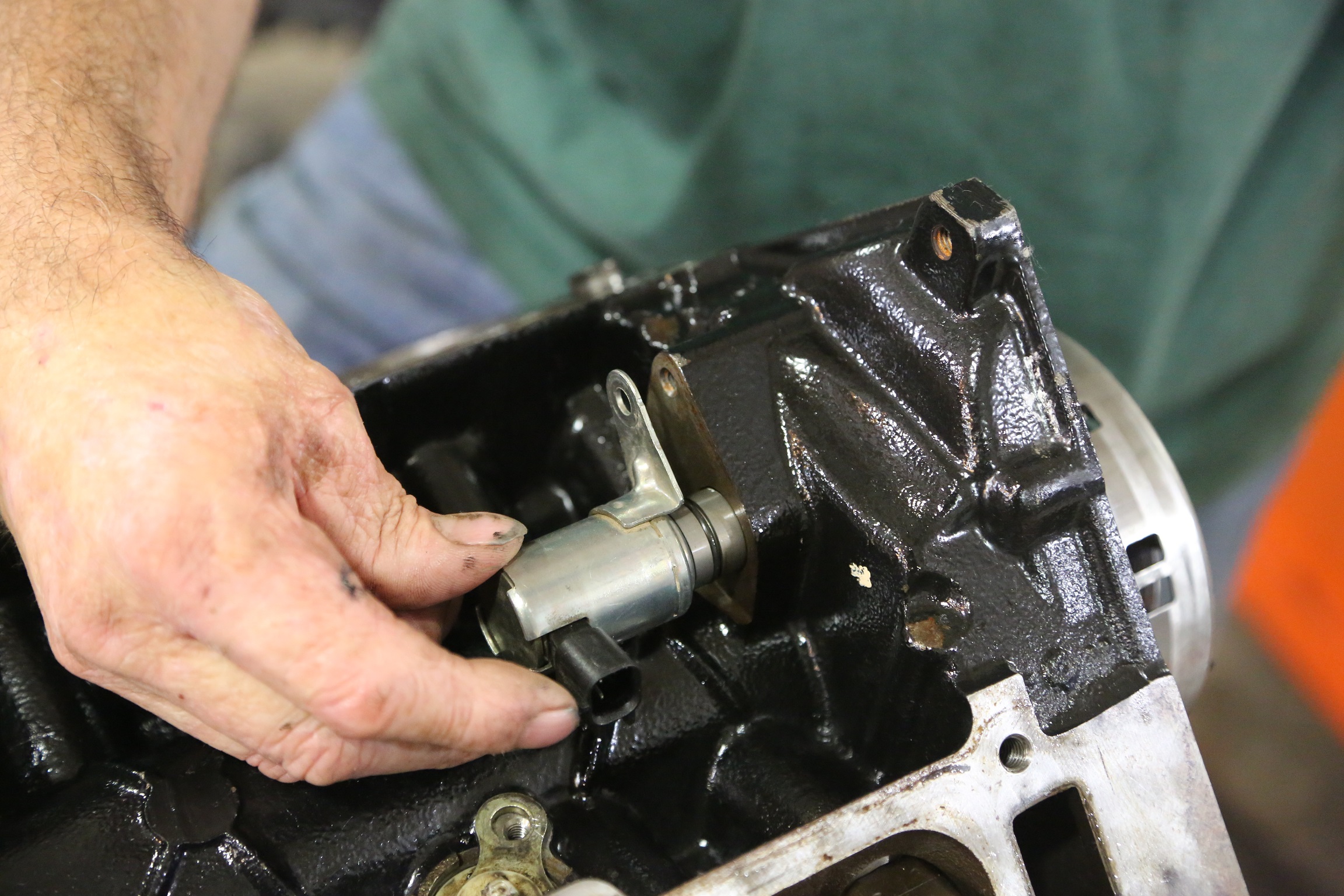

It could be the oil control valve for the vvt cam timing.

I’m willing to bet the screens for the oil control valve have come apart. It was pretty common around 2012.
