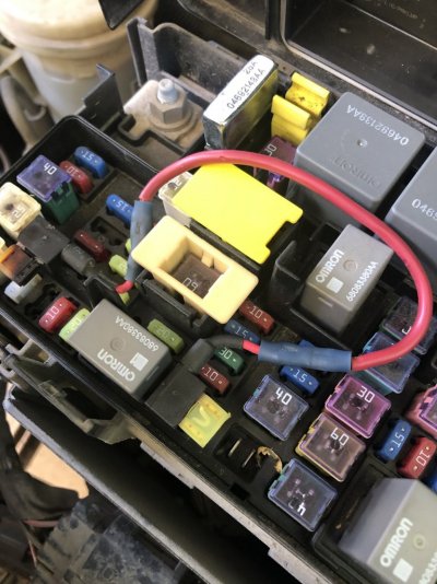

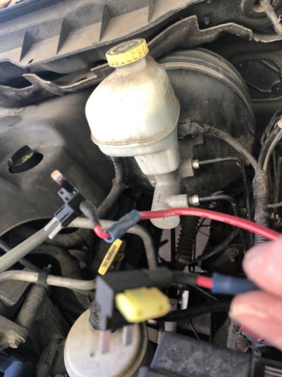

I dont know if you've fixed your issue. But, you may need to make a jumper to power your fuel pump . I had same problem. yoiu can buy the fuse holders at Oreilly...hope this helps someone lol
